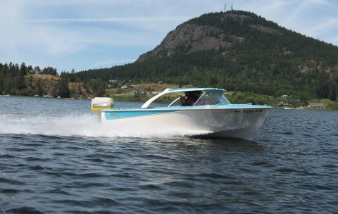

    Is a merc 900 to big for this boat?

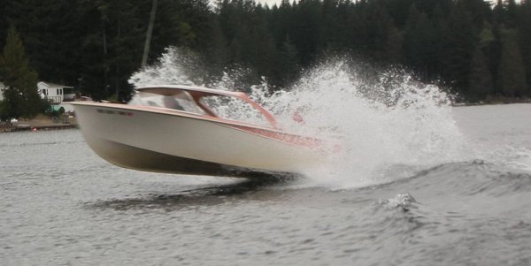

    She will get up and dance with that on the back.
    This is with a 85 on the back and playing in the wake's.

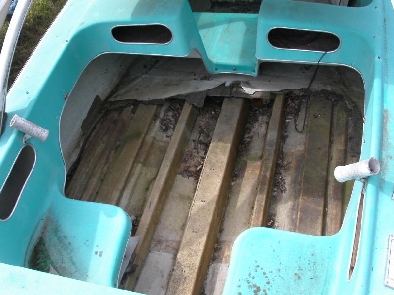

              The Skimaster is different design then the Skagit 17 or Skagit 20. It was designed by Lloyd Lindberry not Howard Roberts. The stringers are completely different and the hull will flex more. They put in a one piece stringer system across the bottom. If you ever take the deck up do not step on the raised part of the stringers. Will send you a picture of another Skimaster that I used to own with the deck removed. Clint

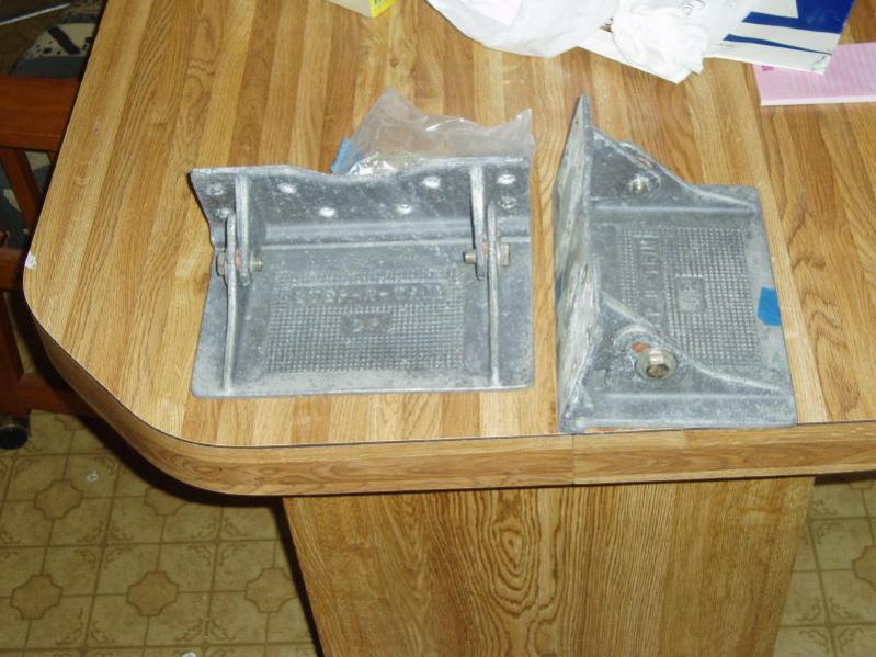

                      Skimaster and Trimtabs
                      Would seem to me that perhaps small Bennett trim tabs would be a possible solution to bow rising. While adding weight to the bow may sound like a good solution, it appears to me that it would be horribly inefficient essentially adding more drag to the boat, especially in this day of rising gasoline prices.
                      The tabs would have the additional benefit of, for lack of a better word, roll trim control. Don't know if anybody has ever tried this on a Skagit, or if it would even work. I suggested this option in the days when we had the Skagit 24 but nobody implemented my idea (I was 14.) Since then every boat I have owned or operated has had them.

                            I may have dealt with porpoising of a Skagit 17 more then anyone else. I may have the most overpowered Skagit 17. I started with a 175 hp V6 Johnson. This was on the boat when I bought it. 100 pounds of lead was in the bow and with the power trim I could get 43 mph without porpoising. The motor would have two be trimmed all the way in to keep it from porpoising. The boat was very hard to steer and hard to drive. I changed to a 140 hp Mercury in line 6. The Skagit still porpoised and should have been called Flipper. We tried 200 pounds of lead in the bow and with me in the bow for added weight we got 39 mph and I was beat to hell in the bow. For my boat adding weight to the bow had no effect on the porpoising. I have since added a large dolphin tail to the motor and step and trim trim tabs to the boat and taken all extra weight out of the bow. This has cut my top speed down to 35 mph, but porpoising is no longer a problem. I have the ability to move my trim for the most efficient ride and smooth ride. I am now very happy with the ride of my Skagit. Power trim really helps in choppy waters. My 16 foot Skagit ski master has a 100 hp Johnson with CMC trim unit. I have never had problems with it porpoising. It is not terribly fast at 34 mph, but it is a pleasure to run. I have found that adding weight to the bow made no difference for me. Dolphin tales, trim tabs, and proper trimming of the motor seems for me what work. Clint
