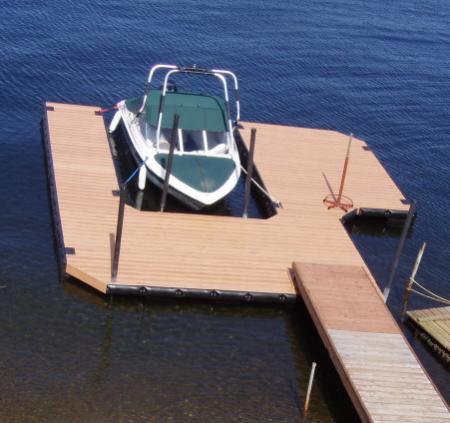

    Now I can get the "Queen of the Cove" back into the water. After 6 years of design, months of working on getting my permit "just right", refinancing my cabin, and 4 weekends of work, I finished my dock project this past weekend.
    Hopefully, I can get my new fiberglass gas tank installed and get the 64' Johnson into the water next weekend. That is, as long as my sunburn heals!

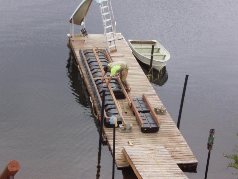

          and i thought i was doing good with my 8x10 platform and 12ft ramp...
          How did you build it (just curious since i just completed yesterday the 8x10 portion and it was a pain to get it into the water, or did you build it on the water.. )

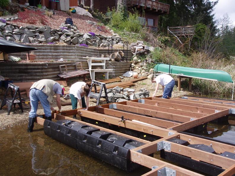

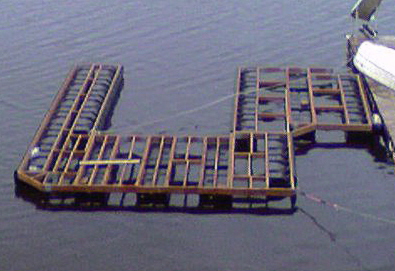

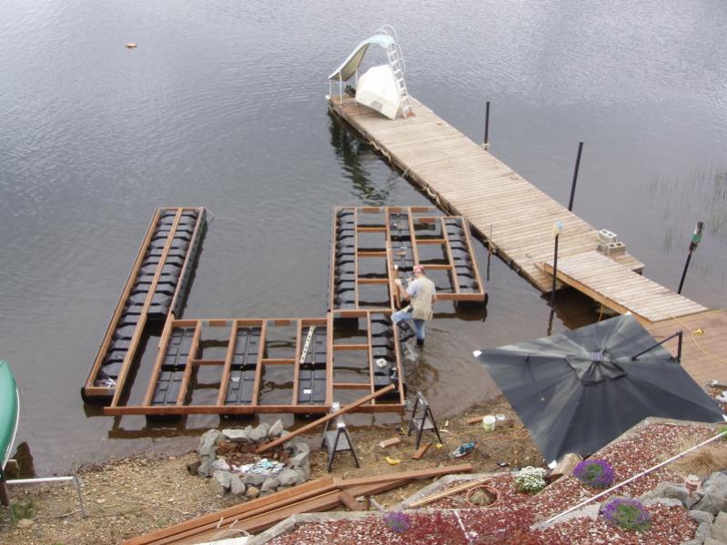

              Building the dock
              Ken:
              I was lucky. I had an old dock that was 8' by 50' to use as a platform.

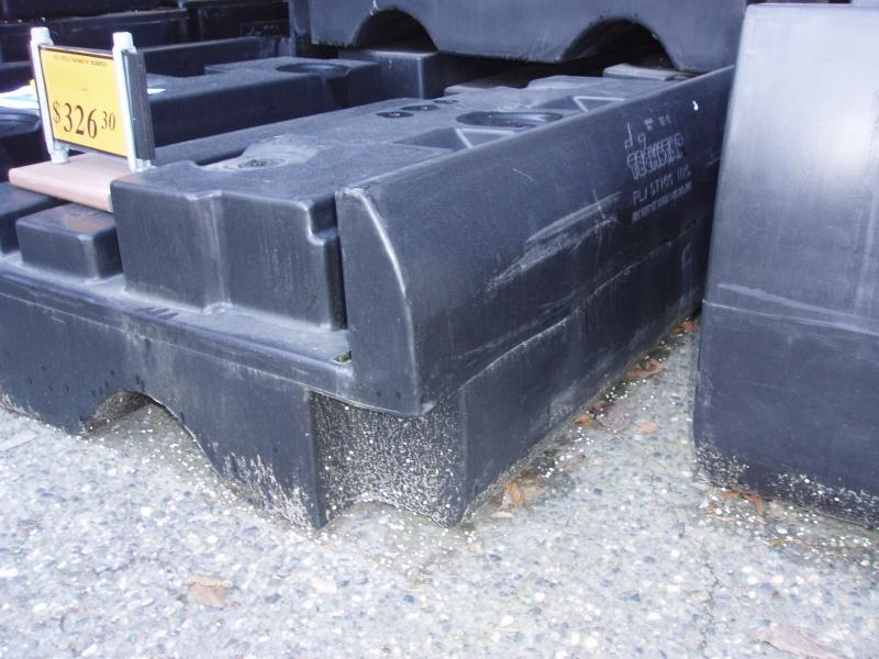

              I broke the dock up into sections and built each one on the old dock. I then slipped them into the water off of the old dock. The neat part of the system that I used, was that most of the dock used a float that had a built-in bumper on the float. 2 by 6's were bolted into the floats and then decking was attached. This made it easy, because you can build the float right side up. Traditional floats have to be built upside down. The brand I used was Tech Star out of Canada. Lucky for me, the have a lumber store in Bel Fair that sells the product.
              Pretty expensive (all docks are), but i would do it again.
              Karl
