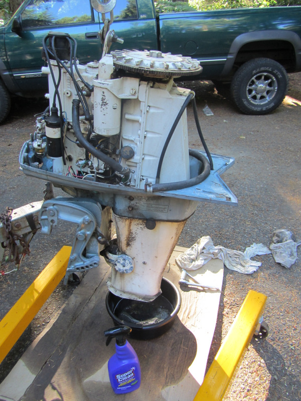

Hi, Thank you all for the help/support just found a 1968 "A" block going to be Winter project but now that I have it I kinda obsessed with getting it going most of it is there, missing shift lever, and carburetor scoops. I need all the bolts to attach lower unit and upper bolts that tie lower skirt cover to upper cowling. Do these bolts have shoulders?. Thanks again, Paul

Hi, Thank you all for the help/support just found a 1968 "A" block going to be Winter project but now that I have it I kinda obsessed with getting it going most of it is there, missing shift lever, and carburetor scoops. Thanks, PaulAttached Files

I am sure there are parts motors around, found them in swap meets even.
Just driving around I spotted a Homelite on the back of a aluminum boat. Looks as its been setting but I think the lower end stuff might be the same.
Supersporter would know that.Helmar Joe Johanesen
Hi Joe, Filled it up with fresh oil but it started dripping I have the lower unit off so it was kinda disappointing any common problems associated with that problem still going to take it apart a little bit this winter but the suns out and great day to tinker.
The carb scoops were only on the early Homelites... the "Jetson" look. As soon as they went to the single piece hood, they had a plastic baffle that bolted over the carbs and pulled in the air from the bottom. Their function was to reduce the intake noise, and not much else, so once they cracked, most of them were removed.

Hi Dick,yes it is A block 1968 it has stopped leaking but I moved on engine stand yesterday and it leaked and then stopped again. My lower unit is pretty stiff wondering about freeing it up with automatic transmission fluid and a litttle acetone any thoughts on that. Paul
