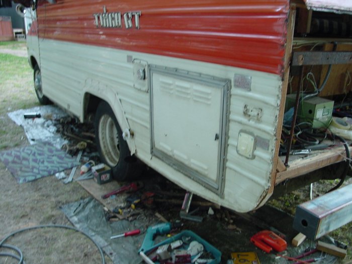

Found More bad wood to replace

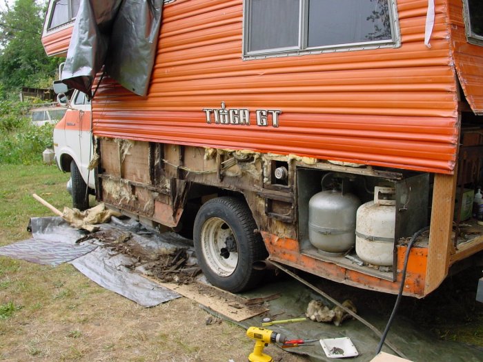

This is what I found when I decided to pull the left side off.
The Sub floor was as solid as the day she was built but it seems that with the roof leaking from day 1, it caused Lots of problems.
Well now, let's look at what needs done here.

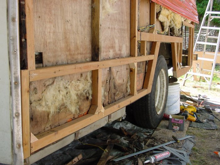

Time to get after it.
Well, This wasn't so bad. I was able to frame this up in only one day. I was also able to run the vertical stringers all the way to the roof and attach to them from the insides.

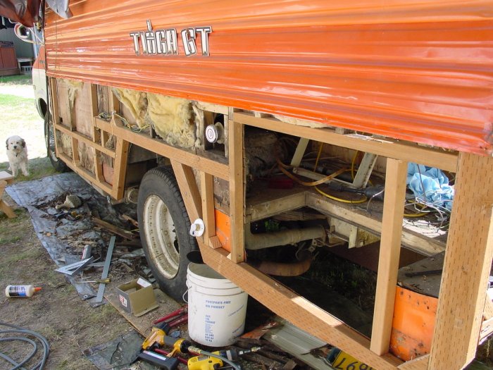

Time to put the propane box back in and get he insulation back on it.
I replace all the wiring from just above the rear wheel as they hit it with a staple and the Bright copper went to Black, Not good.
Now, lets see, were did I put that 3M stickum stuff.
There we go. I moved the Fresh Water inlet from under the wheel well to the side of the RV as so I would not have to crawl around on the ground to hook it up.
Just a tad bit of plumbing and that's done now. Back to the Rear .

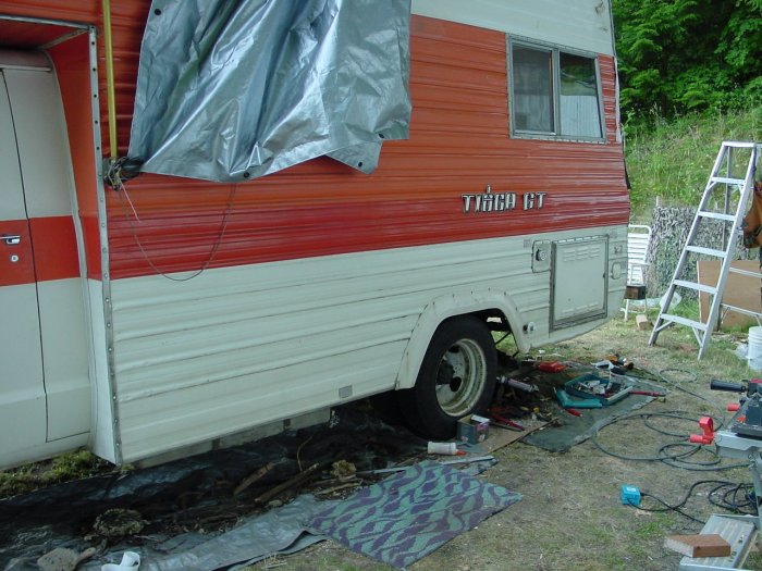

Yep, Everything fit back like it should.
I went under the RV and sealed and Undercoated all of this as not to have it rot out again.
