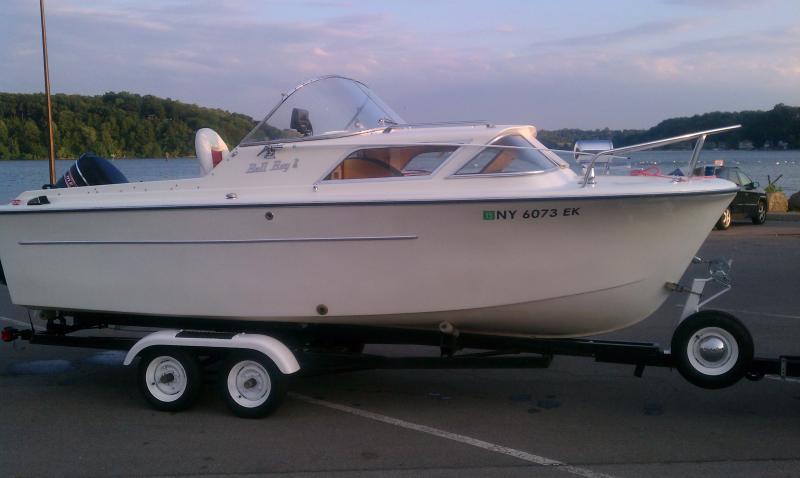

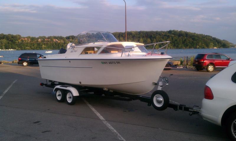

            Ed, I hope you and the other BellBoy restorers are doing well with the projects out there!
            Here are a couple of shots from yesterday's outing at Lake Ontario.
            Best,
            Bob
              Best,
              Bob
              Oh! Pretty!
              Speaking for me- I think it's coming along reasonably well. I'm hoping to start priming this coming weekend. Paint on, assuming weather continues to cooperate, within a month. First time in the water this year.

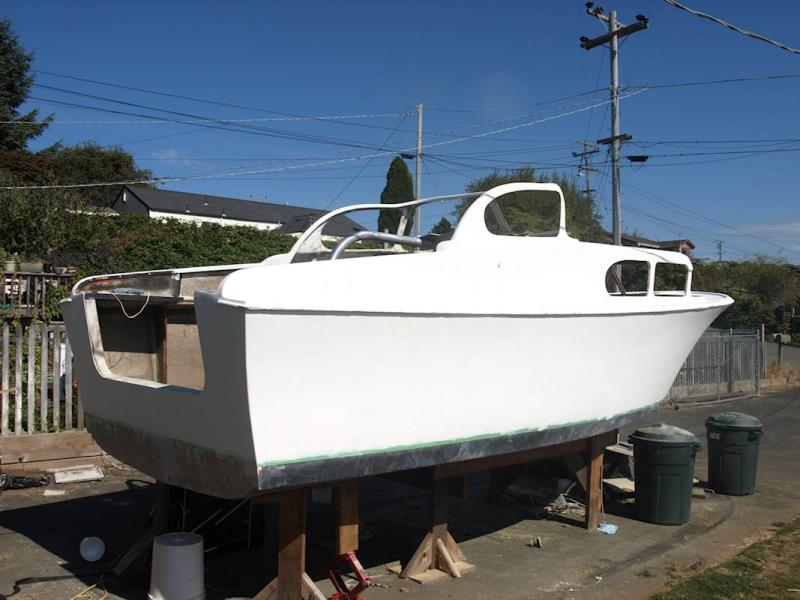

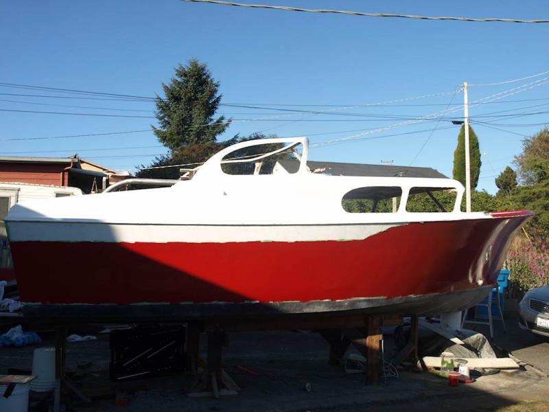

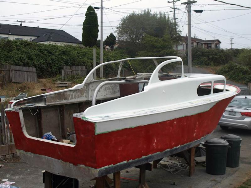

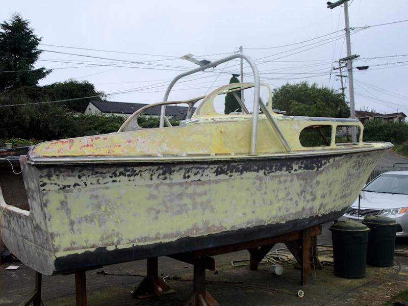

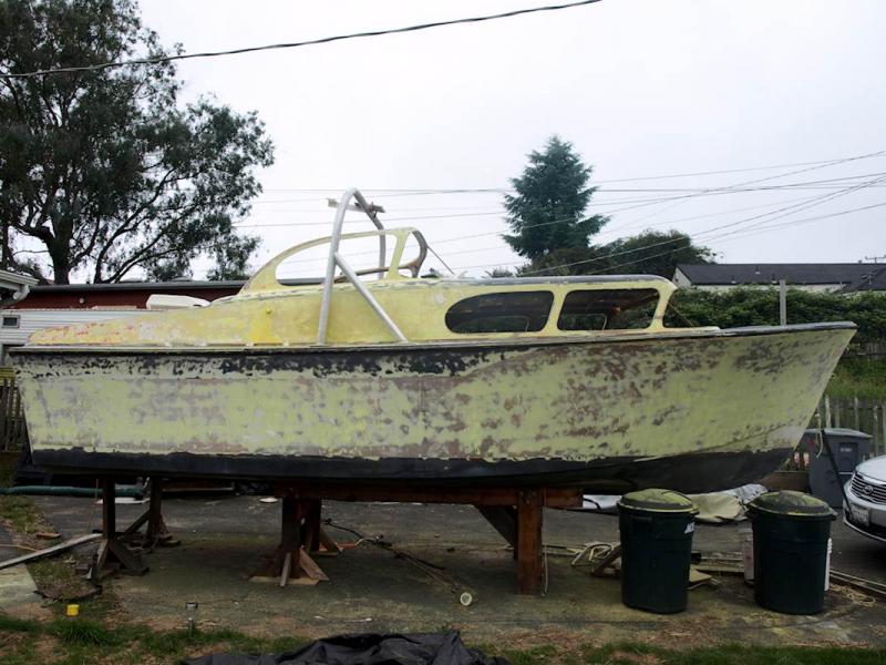

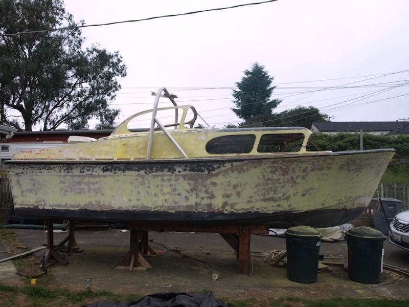

                          It seems like forever since I've posted. Between visits from loved ones and working overtime (I worked at least a couple hours every day for six weeks) I haven't been able to touch the boat. I've been sweating, because my work space is the driveway and I don't have a shelter. I had expected to have the last month or so to paint, but that didn't work out, and once the rainy season starts I'm in trouble.
                          So I was dodging the mist, but we got some sun and no real rain. So here's what the boat looks like
                          • sanded and ready to prime.
                          • with two coats of sanding primer, hull and topsides.
                          • sanded, one coat of Pettit Easypoxy, and a light sanding.
                          • then with four coats. I haven't removed the masking tape yet.
                          There have been so many layers of paint applied that I never did feel 100% sure what the original color was, but I think it was red topsides and hull. I couldn't see my way to applying that much red, but I liked this best of all the looks I tried in my my graphics program.
                          It's not going to complete with Bruce Drakes BBE (Best Bellboy 21 ever), but I think when done it won't be bad for an amateur job.
                          So I still need to let the paint fully cure, and buff and sand, but at least I beat the rain. I also mounted the bulkhead, and precut the pieces that will make the interior panels. I need to fabricate the steering/instrument console, but soon I should be able to get the outboard mounted. Then I can build out the splashwell. When I do that I'll finish painting the side slashes and cockpit interior. Then ... well, anyone reading this probably knows there's still a lot more work to do. But it almost looks like a boat now.
